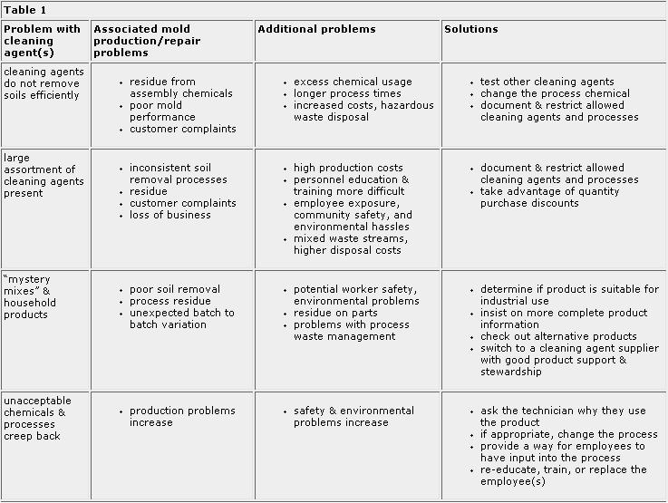

Even if you use water with no additives, water is acting as a chemical. Cleaning can occur in a sink-on-drum parts washer full of mineral spirits, in a tub of soapy water, and in a large, overhead conveyor washer. Have a look at your written documentation; and then walk around the shop floor to see what is actually happening. Some common cleaning problems with cleaning agents are summarized in Table 1.
