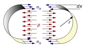

I am a student of Kingswood college, Kandy and planing to appear for A/L under the mathematical stream this year. It would be very much appreciated if you could kindly explain me how to design a Boiler for a given dimensions and presure as I have heard through one of my friend that the Boiler is a very dangerous component.

If you consider any small square in boiler surface , two type of stresses are acting on it as shown in the above figure.
(1) Longitudinal stress ( Sigma_L) (2) Hoop Stress ( Sigma_H).
So all the parts of the boiler wall are in equilibrium under the forces , which are creating from the above two stresses.
So basic principal behind boiler design is the permissible stress of the material , you are going to select for fabricate the boiler must be higher than those Longitudinal and Hoop Stresses. ( For any Pressure).
So first we have to calculate the Longitudinal and Hoop Stresses for given Pressure , Given thinkness and Given Radius.

Hoop Stress Calculation
The free body is in static equilibrium. According to Newton's first law of motion, the hoop stress can be calculated as
So according to two equations , we can say
Hoop Stress = Longitudinal Stress * 2
So if you desingn the boiler for Hoop Stress , It will never fail with the Longitudinal Stress .
Boiler Thinkness Calculation
In Hoop Stress equation apply the values for P (maxium pressure which Boiler is designed) , r (Radius of the Boiler) and
Sigma_H ( Permissible stress of the material you select to fabricate the Boiler) and find the value for t ( Boiler Wall Thickness).
So thickness of the sheet metal you select to fabricate the Boiler should be higher than this calculated thickness value.
If you design the Boiler by selecting the thickness of the material as describe above , Boiler is safe up to design Pressure.
