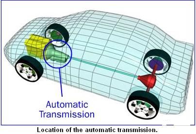

you know that there are two big differences between an automatic transmission and a manual transmission:
There is no clutch pedal in an automatic transmission car.
There is no gear shift in an automatic transmission car. Once you put the transmission into drive, everything else is automatic.
Both the automatic transmission (plus its torque converter) and a manual transmission (with its clutch) accomplish exactly the same thing, but they do it in totally different ways. It turns out that the way an automatic transmission does it is absolutely amazing!
In this article, we'll work our way through an automatic transmission. We'll start with the key to the whole system: planetary gearsets. Then we'll see how the transmission is put together, learn how the controls work and discuss some of the intricacies involved in controlling a transmission.

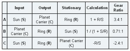

Planetary Gearset Ratios
One of the planetary gearsets from our transmission has a ring gear with 72 teeth and a sun gear with 30 teeth. We can get lots of different gear ratios out of this gearset.
Also, locking any two of the three components together will lock up the whole device at a 1:1 gear reduction. Notice that the first gear ratio listed above is a reduction -- the output speed is slower than the input speed. The second is an overdrive -- the output speed is faster than the input speed. The last is a reduction again, but the output direction is reversed. There are several other ratios that can be gotten out of this planetary gear set, but these are the ones that are relevant to our automatic transmission.
So this one set of gears can produce all of these different gear ratios without having to engage or disengage any other gears. With two of these gearsets in a row, we can get the four forward gears and one reverse gear our transmission needs. We'll put the two sets of gears together in the next section.

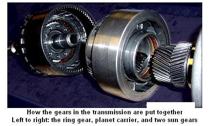

Compound Planetary Gearset
This automatic transmission uses a set of gears, called a compound planetary gearset, that looks like a single planetary gearset but actually behaves like two planetary gearsets combined. It has one ring gear that is always the output of the transmission, but it has two sun gears and two sets of planets.

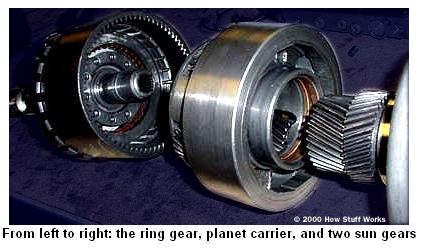

Let's look at some of the parts:

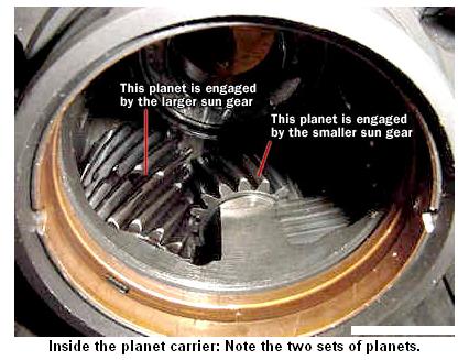

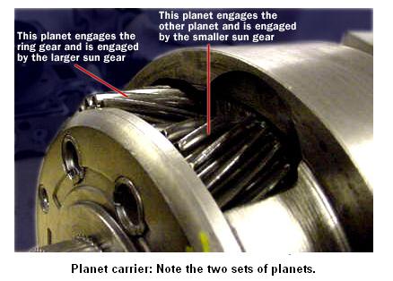

The figure below shows the planets in the planet carrier. Notice how the planet on the right sits lower than the planet on the left. The planet on the right does not engage the ring gear -- it engages the other planet. Only the planet on the left engages the ring gear.
Next you can see the inside of the planet carrier. The shorter gears are engaged only by the smaller sun gear. The longer planets are engaged by the bigger sun gear and by the smaller planets.
The picture below shows how all of the parts are hooked up in a transmission.

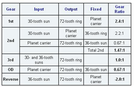

Gear Ratios

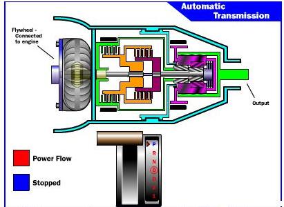

This transmission has four forward gears and one reverse gear. Let's summarize the gear ratios, inputs and output.
After reading these sections, you are probably wondering how the different inputs get connected and disconnected. This is done by a series of clutches and bands inside the transmission. In the next section, we'll see how these work.

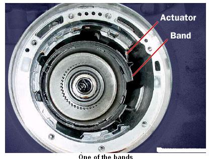

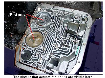

In this transmission there are two bands. The bands in a transmission are, literally, steel bands that wrap around sections of the gear train and connect to the housing. They are actuated by hydraulic cylinders inside the case of the transmission.
n the figure above, you can see one of the bands in the housing of the transmission. The gear train is removed. The metal rod is connected to the piston, which actuates the band.
Above you can see the two pistons that actuate the bands. Hydraulic pressure, routed into the cylinder by a set of valves, causes the pistons to push on the bands, locking that part of the gear train to the housing.

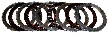

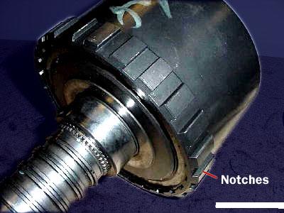

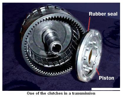

The clutches in the transmission are a little more complex. In this transmission there are four clutches. Each clutch is actuated by pressurized hydraulic fluid that enters a piston inside the clutch. Springs make sure that the clutch releases when the pressure is reduced. Below you can see the piston and the clutch drum. Notice the rubber seal on the piston -- this is one of the components that is replaced when your transmission gets rebuil.
The next figure shows the alternating layers of clutch friction material and steel plates. The friction material is splined on the inside, where it locks to one of the gears. The steel plate is splined on the outside, where it locks to the clutch housing. These clutch plates are also replaced when the transmission is rebuilt.
The pressure for the clutches is fed through passageways in the shafts. The hydraulic system controls which clutches and bands are energized at any given moment.

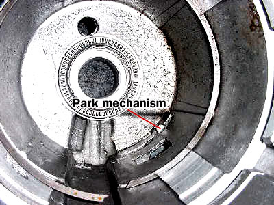

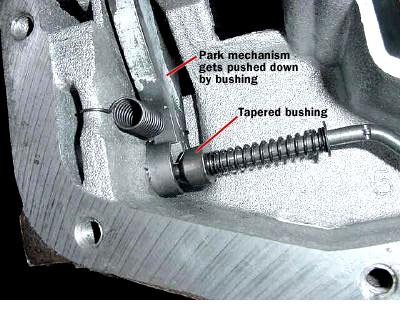

The mechanism that does all this is pretty neat. Let's look at some of the parts first.
The parking-brake mechanism engages the teeth on the output to hold the car still. This is the section of the transmission that hooks up to the drive shaft -- so if this part can't spin, the car can't move.

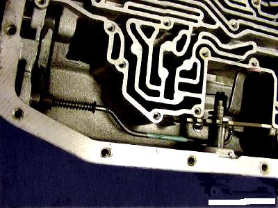

Above you see the parking mechanism protruding into the housing where the gears are located. Notice that it has tapered sides. This helps to disengage the parking brake when you are parked on a hill -- the force from the weight of the car helps to push the parking mechanism out of place because of the angle of the taper.
This rod is connected to a cable that is operated by the shift lever in your car.
When the shift lever is placed in park, the rod pushes the spring against the small tapered bushing. If the park mechanism is lined up so that it can drop into one of the notches in the output gear section, the tapered bushing will push the mechanism down. If the mechanism is lined up on one of the high spots on the output, then the spring will push on the tapered bushing, but the lever will not lock into place until the car rolls a little and the teeth line up properly. This is why sometimes your car moves a little bit after you put it in park and release the brake pedal -- it has to roll a little for the teeth to line up to where the parking mechanism can drop into place.
Once the car is safely in park, the bushing holds down the lever so that the car will not pop out of park if it is on a hill.
