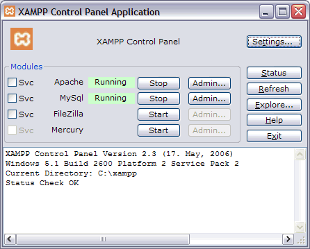

Xammp and Mercury are starting when windows starts up. I want to stop them and start they when i want. Please help

  1. Go into the root xampp folder and and run xampp-control.exe
  2. Before doing anything, ensure that nothing is automatically set to run as a service, you'll need to check in two places. First, make sure the "svc" check boxes are unchecked next to each xampp component item. Second, click the Settings... button in the Control Panel, and make sure that no boxes are check in the Settings area. Click OK to return to the main Control Panel view.
  3. To turn Apache and MySQL on/off, simply click the respective start/stop buttons for each component. The buttons will change state depending on the status of the component. Figure 2 shows the Control Panel with both Apache and MySQL running.
  4. You can make a shortcut of xampp-control.exe on your desktop and start services whenever you want
