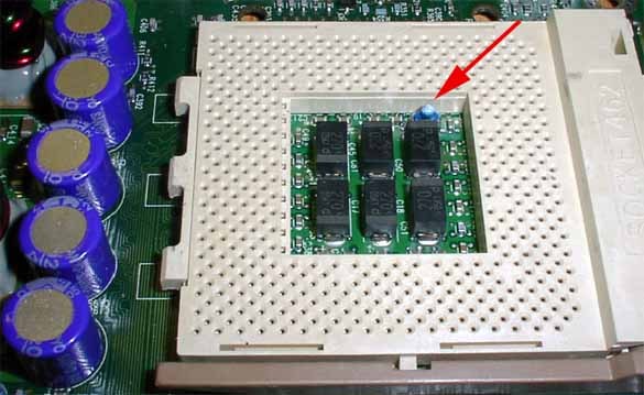

There is another point that came to my mind. It can be the thermal sensor which is malfunctioning after cleaning. Brush the CPU area of motherboard carefully again and see whether it improves. Note that the sensor is usually placed in-between the CPU socket as in the image (the look of the sensor can be different than the one in the picture).
